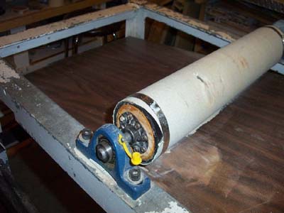

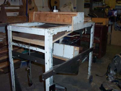

Ron, i saw a picture of your drum sander which seems to be really well made BTW. The nice thing about home made ones is that you can decide on the size of the drum,motor and pulleys and they're quite easy to make and besides, you save a load of money! You can either build a hardwood frame or weld one.
Kim, if you were to say you wanted to build yourself a bandsaw, i would try to discourage you, i've tried and it was really too hard to achieve, not enough information out there unless you were a machinist. But a drum sander ? Man, if i could do it, believe me, you certainly can, you don't really need a power feed at first, you can feed by hand as long as you have side guards, a dust collection port over the drum that will hide the pulley, belt and pillow block bearings so nothing from your body comes in contact with those parts.
My motor is a 1/2 hp and does 1725 which is plenty for starters, my drum is 3" black ABS PIPE. if you have any questions, PM me and i'll be glad to tell you more about it!
Here's a couple of pics
cheers
